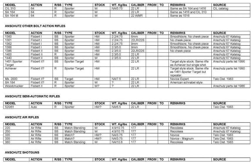

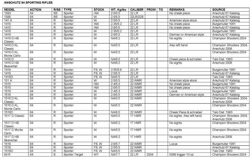

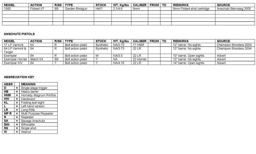

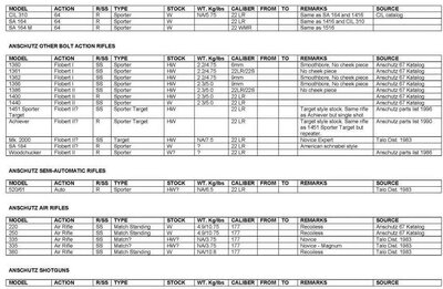

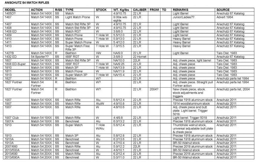

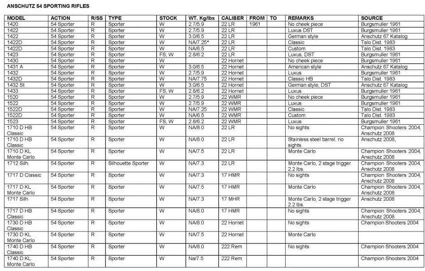

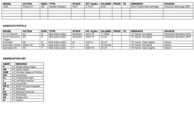

GUIDELINES TO ANSCHUTZ MODELS:
14XX - The rifle was made between 1954 and 1980. Rifles made 1954 -1976 have the wing safety bolt, and a straight handle.
Rifles made from 1977-1980 have a trigger safety, and conical bolt cap, plus a redesigned trigger and firing pin. Serial numbers
end in an X. Handles were straightb in '77-78, and curved in '79-'80. '77-'80 vintage rifles are often called 16xx, or Transitionmodels,
or X-Barrels to differentiate them.
18xx - The rifle was made between 1980 and 1987. The action/bolt/trigger is very similar to the 16xx, but with enough
differences that bolts/triggers are not interchangeable.
19XX - The rifle was made in 1987 or after. The action is the same as the 18xx (bar one miniscule change). The foresight
mounting switched from a dovetail block to grooves cut directly into the muzzle (now a slightly larger diameter to suit). the
1907 has a slightly shorter and lighter barrel than the 1913. The 1907 can also be found as a repeater, although extremely rare
XX13 - AKA The Supermatch. This is Anschutz's top of the line Olympic Free Rifle. It has a walnut thumbhole stock. The butt is
adjustable for LOP via a thumbscrew, and height, and offset/cant after the late '60s. Post '73 the cheekpice has been adjustable.
Barrel is 69cm long and about 24mm diameter.
XX11 - The Prone rifle, Made 1954 to about 2000. This had a broad, straight fore-end. It has the same heavy 69cm barrel as the
XX13.
XX07 - 1954-1964- A Lightweight 9lb rifle.
1968?- Present - The UIT Standard, an 11lb rifle in a basic 3-P stock. The barrel is 66cm/26in and lighter than the XX11/XX13.
The fore-end is deeper than the XX11 or XX13. Most XX07 for-ends are flush with the triggerguard and then taper up.
XX10 - 197? -2000ish, a cheaper version of the XX13. It has the same barrel but a different stock. The stock is beech, and the
fore-end tapers like an XX07.
XX09 - 1960s - A cheaper version of the 1413, without the LOP adjustment.
1970s-2000 an XX07 barrel in an XX10 stock.
XX08 - 1965-196? Anschutz's first UIT standard rifle, for reasons unknown the model number was changed to 1407.
1970s- Running Target rifle.
1912 - 1997-Present, a scaled down 1913 with a 1907 barrel to meet the 6.5kg weight limit for the ISSF Ladies Sport rifle rules.
Hunting and Sporting Rifles
14xx Sporting rimfires are built on the 64 action
17xx Sporting rimfires are built on the 54 action
1770 Current Centerfire Hunting production in .223 caliber only, medium weight barrel
1780 Current Centerfire Hunting rifles in 308, 30-06, 8x57 IS, 9.3x62
Anschutz has marketed is 64 action through third party vendors such as CIL in Canada, and Weatherby in the U.S. To my
Anschutz 54 action has never been used by any other manufacturer other than Anschutz.
Markings
D - Single stage trigger
E = Singler loader
G = Barrel thread
HB = Heavy Barrel
FL = Folding leaf sight
L = Left hand version
MP = Multi purpose
R = Repeater
Silh = Silhouette
XX13.
Markings
E = Singler loader
G = Barrel thread
HB = Heavy Barrel
MP = Multi purpose
R = Repeater
Silh = Silhouette
