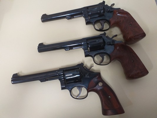

Re: REVOLVERI ZA KLASIČNO STRELJAŠTVO U CAL..38SPL
Post by istra champion » 10 Jun 2020, 12:04
3 Target Masterpieca; K17-3, K14-2 i 14-3.
Post by Onty » 10 Jun 2020, 22:40
istra champion wrote:3 Target Masterpieca; K17-3, K14-2 i 14-3.
Moje čestitke, zavidim ti.
